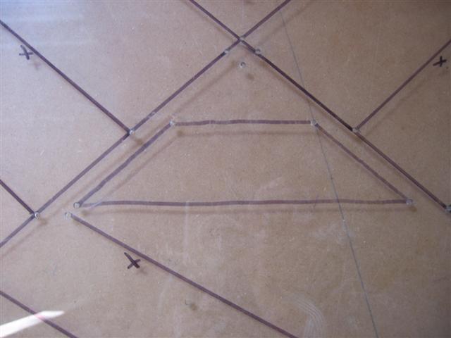

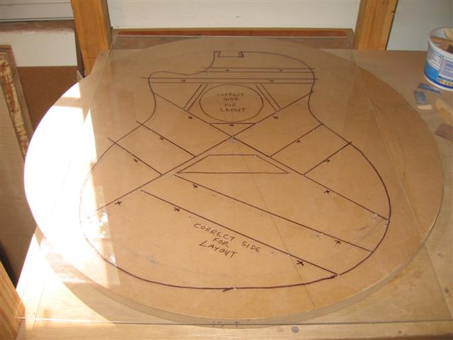

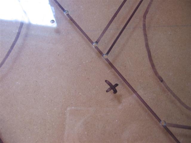

Go to the home center and buy a sheet of plexiglas, remove the wrapping, make dots at strategic locations, drill 1/8th inch holes at those dots.
Using a sharpie and a ruler, trace at least one side of a brace onto the plexi, put an x on the side where the brace goes. Also draw in the outline of the guitar and soundhole, if the top. Simpler is better.
Use the plexiglas template now to transfer your paper pattern to the top or back, I have one for both sets of braces. Following Hoffman's lead, I use one bracing pattern for all of my guitars.
Clear? Questions? Sorry, pics maybe tomorrow. bd

Boy Rossy that was clear as mud. Drill holes, use a pencil to make dots on your wood. Connect the dots like Rod sez drawing lines onto your wood. Place an x on the side of the line where the brace goes.
In other words, your pattern is now a series of drilled holes and you simply dot your wood and draw lines for the braces, whew! A picture would be great here.....

Here is a Hoffman Recycled Idea, I spoke of above. Very accurate, cost is ten bucks per plexi sheet.
Bruce Dickey38825.455625

Ross, sometimes we forget how basic the problems we encountered early on in the building process are. Great question.
In your honor, I just put up an addition to my Jigs and Tools page. There may be some other things of interest there as well.
Dickey Guitars, Jigs and Tools
Here is a direct link to the Brace Template, as seen above.
Aha, that was a two part question. I see the guys got you covered on cutting the brace slot/angle notch. In the picture above is a jig hanging on the wall. In that jig and using a router with a 5/16 inch single bit, I cut fourteen brace notches at once. Again, that is a rendition of a method portrayed at www.hoffmanguitars.com That Charlie, he's the greatest! And he builds a great guitar too! I finally got to play one at Frank and Richard's.Bruce Dickey38825.5009837963

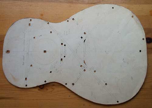

A simple and inexpensive way to layout for braces is to first layout the pattern on poster board. Layout the braces using their full thickness. If you have a 1/4" brace, draw two parallel lines 1/4" apart. Towards the both ends of each brace, take a sharp knife and cut out a small box the width of the brace. All you need to trace onto the actual top or back are these little box cutouts. The braces are then glued to cover the traced boxes.
The pictured template has had a few changes made to it over the years so it has a few extra cutouts. It's not as durable as Bruce's plexiglass but quick, cheap and effective.

Nice template Scott. I was somewhat amazed when I went to Charles Fox's class, to find that almost all of his templates are made from posterboard. He has had some of them for many years and they are still fine. If you think about it, they really don't get that much use or abuse, so they should last as long as plexi or anything else.

This is pretty much the same system that I use. Thanks Scott, that saves me taking a picture!

Dave, you are right, the idea for the posterboard template came from Charles' GRD class. The pictured template is at least 25 years old and has survived numerous moves. I guess one could make it from plexiglass but it would be a bit more work to cut and file the little squares. I do make my half pattern templates from plexi so that I can see through them and so they maintain a hard edge for tracing.
Charles used to joke that that guitars would steadily get bigger by the width of a pencil line as templates were copied over and over.

Mine's just like Scott's too. That's the way Kinkead shows it in his book. Works very well.
